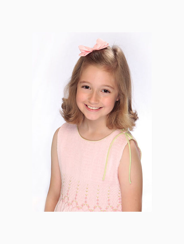

First read my tutorial approach for lighting white backgrounds perceptually here: LINK
From the tutorial you'll understand why I expose the background for 250 not 255 clipping: a 255 background make solid white in the subject seem duller by comparison and any 255 specular rim lighting would be lost in the background.
In PP I adjust the highlight eye dropper in PS to 250.250.250. Do that by double clicking the highlight eye dropper in Levels then changing the default 255 setting. When closing the color picker you will be ask "Make new settings default". Click yes. Now anything clicked with highlight eye dropper in levels turns 250.250.250 not 255.255.255.
Next I click the highlight eye dropper on white BD close to the subject snapping it neutral 250.250.250
Then I fill a new layer with 250.250.250 and erase / mask out the doggie in the window. Since the BG is click corrected to 250 around the subject there's no need for precision in the masking so it takes all of about a minute to do.
SOOC - note un-even BG tone
250 layer on top with subject erased out of it.
If used on "white" web pages I set the background value of the web page to 250.250.250 also.
The thing to realize about how white is perceived is that the brain adapts perception to the brightest largest white thing in the FOV as the "anchor" for the perceived tonal range. So the viewer sees 250 white as being the same as 255 when their pupils and brain adjust to it. Again keeping the BG and solid white objects in foreground at 250 is what allows the 255 specular highlights to define high points and create the 3D illusion on white solids.
Below the small highlight catchlight at 2 o'clock and the circle depicting rim lighting are 255. Note how perception of 3D shape changes when background is 255, 250, and 240:
In terms of what is really important THE DOGGIES it would be better perceptually to photograph those B&W mutts on a med. gray BG that would contrast with both the white and dark fur. The whites will look brighter by comparison and without the glare of the background causing the viewer's pupils to constrict the range of their eyes will see more shadow detail in the black fur.
I also have a tutorial on lighting furry critters you might want to read: http://photo.nova.org/Fur/

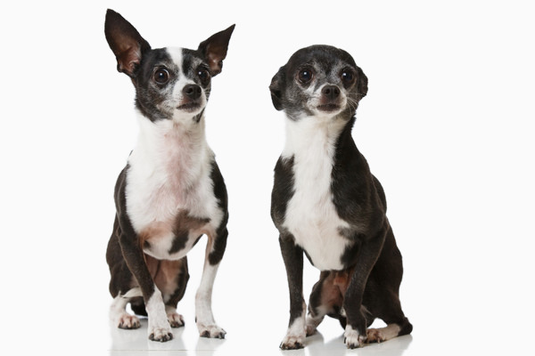

So I think I have a simple workflow that appeared to have worked. Here is the photo I was trying this out on.
Something does seem strange. As I pass around the "white" background with a color picker, not everything is 250/250/250. They are close but not all exactly the same.
If I had a fill layer with 250, then every pixel outside the mask I would have expected to be 250/250/250, but they are not.

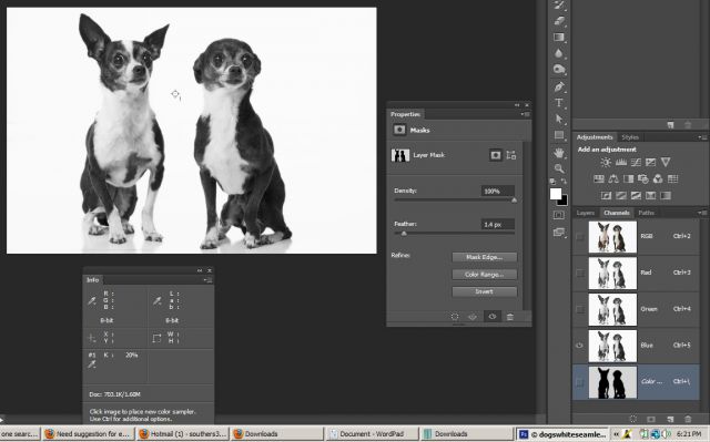

Took a stab at it ... using channels & levels to create a mask, applied to a (250,250,250) color layer (i.e. no brush work).

Following the steps from Dennis (eyeball), I was able to perform the tasks. I found this method much harder than what I posted a bit earlier where I did the selection of the subject and then erased within the mask.
Much quicker, however as I noted above, I can't figure out why not all the pixels outside the mask are not 250/250/250.
Rustybug, how long did it take you to perform the edits and what are your specific steps.

Here is what I ended up with the dogs after following Dennis's last workflow.

RustyBug
p.1 #18 · Need suggestion for editing white seamless
It took about 2 minutes ...
Channels
Highlight Blue Channel
Hit Load Channel As Selection Button
Layers>New Fill Layer>solid color
Choose color at vivid color to make it easy to see (I chose red)
You'll now have two layers ... click on mask for the color fill layer, go to Images>Adjustment>Levels and crank on the black slider till the mask darkens to the edges of the dogs. Touch up a few spots on the mask that got missed. Feather the mask as needed.
Click on the color layer and switch the color from red (255,0,0) to the (250,250,250) that you want for your background.
