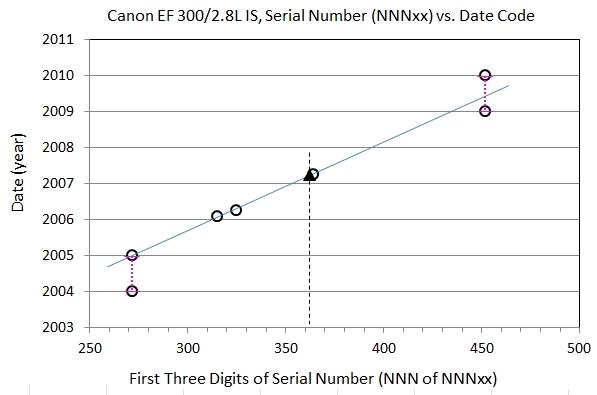

jcolwell
p.1 #19 · Canon 300L 2.8 IS missing a date code
I agree with Leon.
Here's a scatter plot of the data posted to date (open circle symbols), and with the unknown date of OCGO's plotted on the straight line fit as a solid triangle, at the correct serial number. The left- and right-most points show a one-year spread, because only the letters of their date codes are known.
OCGO's lens date code was almost certainly UV, most likely UV03xx or UV02xx.
Cheers, Jim
P.S. the right-most UX (2009) lens is the one I sold last year.
P.P.S. this assumes that the first two digits of the date code (after the two letters) are the month, as mentioned earlier by Leon; I don't recall hearing this before, but the data sure fits.
Feb 07, 2013 at 08:55 PM
OCGO
p.1 #20 · Canon 300L 2.8 IS missing a date code
Thank you everyone, investigating down to a likely year is more than I expected when I posted last night and I appreciate all your input, I even got a graph! I can confidentially stick to my price and wait for the right person to come along.
Feb 08, 2013 at 12:13 AM
