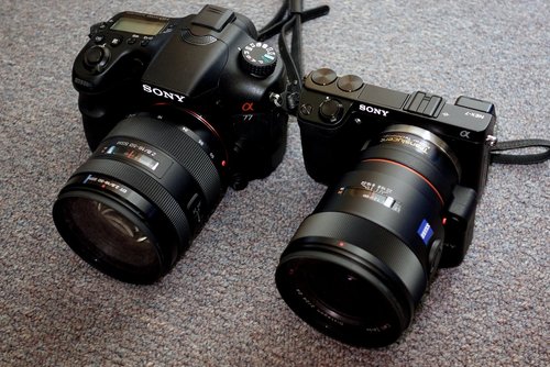

My experience is that draw to the entire system, besides size, Image quality and sometimes; the lower price, is the fact that you can any of the best lenses ever made on the system.
Personally, I don't see the draw to do what you are describing. Unless you already have an A mount body and wanted to use those lenses in addition to others on a Sony NEX.
Doesn't really save size (see photo)and the AF wouldn't be exactly as good as a regular A mount camera. It would be better than the AF on E-mount lenses.

I think if you're really interested in using only a-mount lenses, I'd probably still go with a Sony a-mount DSLT. I don't know if you've handled something like the a55, but it's really pretty compact (even smaller than the a77 in the picture above), and you'd get built-in stabilization, which is huge.
Now, I do think it makes sense to have both an a-mount body and a NEX body, and use a-mount lenses on both. This way, you can pick the best body for the situation.

Length might be the same, but don't forget weight. The LA-EA2 weighs a fair amount, around 200g I think? Which is more than many small lenses.
My LA-EA2 + ZA24/2 (same as in plasticmotif's picture above) is more or less the same size/weight as a Zeiss ZF 100/2 Makro-Planar.

Note the LA-EA2 and 35 is MUCH longer than the native 35/1.8 OSS and the 24/2 itself is much larger than the 24/1.8 even before the LA-EA2 is factored in. The Minolta 24/2.8 on an LA-EA2 is comparable in length to the 24/1.8 but otherwise larger (the LA-EA2 is thicker than the LA-EA1 due to the extra section below the mount tube, and the 24/2.8 is larger diameter than the 24/1.8). The only matchup that's equivalent in size is the fast 50's and the 50/1.8 OSS is optically superior to any of the fast A mount 50's (Owned them all, liked the rendering on the DT50/1.8 best but otherwise the 50 OSS was significantly superior optically to the 50/1.7, 50/1.8 or 50/1.4).
Now the 85/2.8 is another thing, it's a gem, there's no native equivalent and it's very compact on an LA-EA1 or LA-EA2. Note it AF's on the LA-EA1 (albeit slowly). Frankly I keep my LA-EA1 around just for the 85/2.8 SAM.
