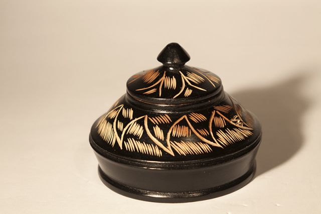

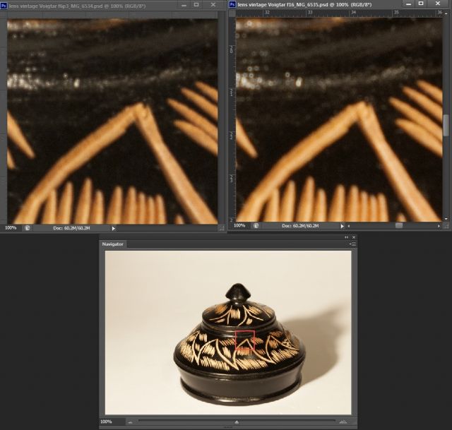

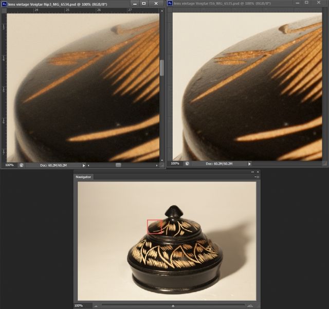

There appears to be significant focus shift for close subjects. The second set of example crops are of a little doodad jar thingy, shown in full frame in the first photo of this set. The next two images show three panels each: the top left panel shows a 100% crop with lens wide open (f/6.3); top right panel shows 100% crop at f/16 (approx); and, the bottom panel shows the PS CS6 Navigator window, with a small red square to show the location of the 100% crops.
The first set of crops is at the point of focus (LiveView MF). The f/6.3 wide open image at the top right is noticeably sharper than the f/16 stopped-down image at the top left. OTOH, when looking further back, along the leftmost, top edge of the jar top, you can see that the f/16 image gets pretty sharp.
