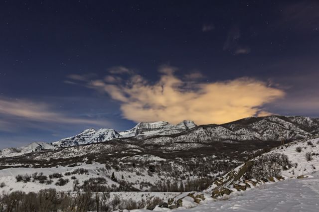

Well, this probably won't be very helpful but here is what I was able to do with some limited time this evening.
First, I'll just repeat again that I think you might want to try increasing exposure. You can always pull the exposure back down in post so it looks like you want but by exposing more to the right, you will get more tonal values out of the noise floor. You may run some risk of clipping the stars and losing some subtle color in them but as it is now you are probably losing that subtle color anyway with your noise reduction.
Here is just a reminder of how dark this image is using linear gamma of 1, the "natural" gamma of the raw file. Those darkest 2 or 3 stops of the image have many fewer tonal levels than the brightest stops. I'm sure you've probably read several of the "Expose to the Right" articles on the web, Ben, so I won't repeat all that here but just take this as a reminder. I think it could really help this type of photography and it may be the reason you are seeing different results from some of the sites you referenced.
Here is a comparison of different Noise Reduction packages. It is not perfect by a LONG shot but maybe it will give you a rough idea. Comparing NR packages is much like comparing raw developers - there is no common baseline for types of settings and setting amounts so it's almost impossible to do an apples-to-apples comparison. It's also easy to favor the package you use most because you are more familiar with its controls and how it works. In my case, that would probably be Imagenomic's Noiseware although these days I really use Lightroom most of the time.
I tried to select 3 representative patches from your image: dark blue sky, clouds/sky/mountain, and some foreground trees/brush. Everything was ran through ACR for raw development but ACR noise reduction and sharpening were set to zero for all tests except the ACR NR sample.
All of these packages have a variety of settings that can be tweaked and then you can do selective masking like you're looking at with BIF so it is almost certain that none of the samples above reflect the best of what could be accomplished with each package. I obviously haven't made the case but I still feel that you are going to be able to achieve better results with a specialized package over ACR/LR, particularly when you start adding sharpening but I could be wrong. Perhaps if someone wants to give LR or ACR their best shot, I will do a "best shot" approach with one of the other packages and we can compare. I may not have time to do that until the weekend though....Show more →
On thing I forgot to mention: I was pretty impressed with Topaz. I have used it before to correct banding noise on my 5D2 but I had never used it much on this type of image. One negative thing I noticed though is that it seems pretty easy to smooth the sky to the point that some posterization effects start to appear. I can even see a hint of that in the sample I posted if I look at my display from the side. Just something you might want to be on the lookout for if using Topaz.

I found an image from the night that was exposed nearly to clipping in the snow areas. You are correct, it cleaned up better. I would have needed to use a sky from another image and it needed a lot of post processing darkening.
Next full moon I will do some experimenting with exposure.
Thanks for your work, I need to play with Topaz denoize which is the only plug-in I have at the moment that runs at 64bit.
The tricks and techniques suggested here work for the 1DS-mk3 as well. I am finding the ACR NR tips and the Topaz tips working fine. Also the tip for a brighter exposure. Although I will need to really think that one through as far as brackets are concerned.
One other thing, This location is not ideal. To freeze stars, you ultimately need to stop down and then DOF is limited. You need a place without much near detail, especially dark detail.
One of the best places I found was in Zion where the bright reflective rock made a great foreground.
Are you hitting the hyperfocal distance? Whilst a smaller aperture gives great focus, it also gives rise to greater diffraction which works against your detail. Is there any value in stopping down past f5.6, given that the sweetspot of any lens is usually ~ 2 stops above its widest aperture.
Thats movement on the stars, less to do with mis-focus. I dont see how stopping down much more will help.
Remember WB can really affect the level of noise in an image, try it and see. Have you considered a differential WB for sky and foreground, it would also add a more appealing contrast (IMO).
I will take noise over motion blur any day. Noise I can deal with, no detail I cant. That last image like to have seen at 5.6 and 2 stops less shutter.

Also SmartSharpen can correct very minor amounts of movement blur. One could apply it as a fully masked layer and just paint back in the stars. Would take ages but its exactly the kind of OC thing that I would do.
I want the stars sharp so I can't do hyperfocal. I focus specifically on either a star or a very distant light.
For serious work, I need a shorter shutter or a wider lens to stop star motion. This was not serious work, I wanted to look strictly at noise and simulated shots that would produce it.

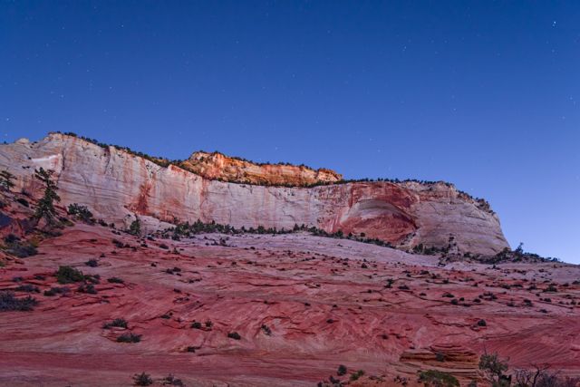

My 17TSE at f4 is a great night image lens. Also, for serious night images, I like to find places like this where the natural reflection is good and there is not a lot of shadow detail to pull up.
