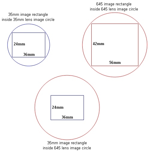

p.1 #6 · Medium Format FOV Calculation
Thanks for the diagrams.
If you got a 35mm image circle and put a 1.6 crop image rectangle in it (say a 50/2 R Leica on a 7D) it would look something similar to the 645 image circle with the 35mm rectangle inside (Mamiya 80mm on 5DIII).
Why does the FOV change for the former and not the latter?
Jan 26, 2013 at 04:20 PM
mpmendenhall
p.1 #7 · Medium Format FOV Calculation
The FOV does change in all cases (when moving a lens between different sensor formats). The focal length of a lens, e.g. 80mm, is not the field of view --- it's the combination of lens focal length and sensor size that gives field of view. Change the sensor size and the field of view changes, but not the focal length.
Because people typically calculate "crop factors" relative to the size of your 5DIII sensor, no "crop factor" (or, a "crop factor" of 1.0) is necessary --- you are asking "putting what focal length lens on a 5DIII would give the same field of view as putting an 80mm lens on a 5DIII?", so the answer is 80mm. You would need a different answer for a different question, e.g. "putting what focal length lens on a 5DIII would give the same field of view as putting an 80mm lens on M645," (in which case the answer would be ~50mm).
