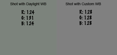

If the photographer had the subject hold the gray card in a test shot he still wouldn't see the color cast on the card in the playback because his color perception adapted to the + green light. But if when back at the computer his first action is to open the file with the card and click it with the white balance eyedropper that will cause the image to shift to neutral as the file values are adjusted to the degree needed to make the card R=G=B. In addition to changing the color of the image knowing how a gray card works also shifts what the photographer trusts as the "baseline" for when the color is accurate. Toggling between the SOOC version and the adjusted one the photographer will be able to see how much the SOOC capture deviated from the Daylight capture baseline. The adjusted version will look neutral and the SOOC green BY COMPARISON.

Outdoors and indoors I set the camera WB to "Daylight" as a starting baseline before shooting the gray card to set Custom WB. That might seem odd when shooting in tungsten or fluorescent light indoors but by comparison with a shot of gray card target after setting Custom WB I can toggle back to the first shot and visualize how the ambient light deviates from the Daylight baseline. For example under trees in green bias light the before/after comparison in the playback would look like this because my brain would trust the second Custom WB frame as being neutral:
