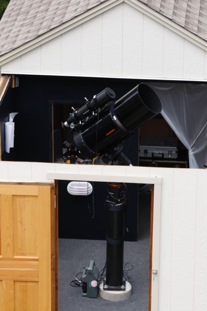

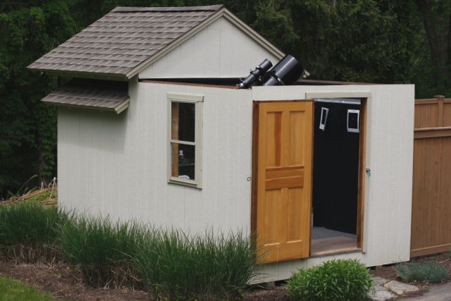

Most would be in agreement that when it comes to Astronomy and Astrophotography it is mount first , optical tube second. Purchase the best quality Computerized ( Go-To) German Equatorial Mount you can afford. This will usually mean a investment in the $2,000.00 and up range and then an optical tube assembly of your choice. The OT could be a Refractor, Reflector or Schmit-Cassagrain. Other OT designs are available but are expensive. The later mentioned OT's will vary on a wide range of cost based on quality. With astronomy equipment..........you get only what you pay for.
This hobby can be great fun DSLR's and web cams along with freeware offered for processing has opened many doors for Astrophotography by the backyard amateur. Build a backyard observatory to cover your gear and away you go.......
