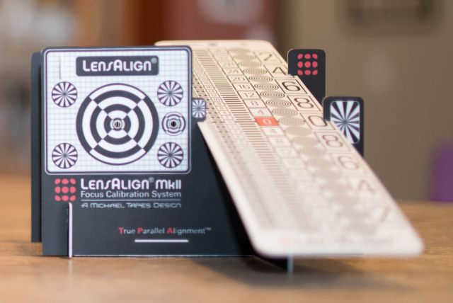

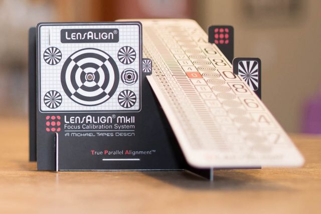

Here are my findings. D800 does require +15 or so of MA. D600 Requires none so maybe that could be an issue.... I dunno.
Both shots below are cropped to fit focus calibrator chart.
EDIT: After some more testing, I'm even more confused. It now seems the D600 also need MA of about +10. More in line with the D800, but I'm getting some inconsistent AF which is making it hard to determine what the actual problem may be.
D600 Outermost Right hand Focus point
  NIKON D600    35 mm    f/1.4    1/200 sec    400 ISO    0.0 EV
D800 Outermost Right hand Focus point
  NIKON D800    35 mm    f/1.4    1/200 sec    400 ISO    +1.0 EV
