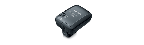

If you use the Canon GP-E2 GPS on the 5D III it will GPS tag any RAW files for JPG files created by the camera. Just mount the GP-E2 in the flash shoe and set to the ON position.
If the GP-E2 tagged the RAW files with GPS coordinates the conversion to DNG format should keep those GPS tags intact.

Canon GP-E2 GPS receiver
