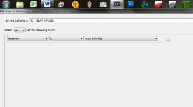

I have a lot of TIFF files which are 16-bit Grayscale images. I am attempting to make a “Collection” of just those images, separate from any color images, but I'm having no luck.
I started with Lightroom ver.1 some years ago and have upgraded through the years to my current ver. 4.3. I’ve searched the web and this forum but to no avail.
All I can find leads me to selecting the “Treatment” = B&W. That only seems to find RAW files which I have modified with the B&W development settings (within LR4). The attached screen shot here shows the only option in the Lightroom "Collections" that I can find.
Any suggestions much appreciated. Thank you!

This won't help for existing images but it may be something for you to consider for new conversions:
http://morethanwords.be/blog/en/a-quick-lightroom-tip-for-bw-photographers/
Beyond that, I think you are stuck with re-tagging the existing images or finding some other characteristic that more-or-less matches the same images. For example, you should be able to filter for TIF files. If most of your TIF images are B&W, that might help; if you have a ton of TIFs in color, not so much. I would suggest going through all of the filter options and see if there is one that, for whatever reason, selects a group of images that is similar to your B&W group. Even if filtering in this way does not do a perfect selection, it may be a good way to re-tag, at least compared to doing it image-by-image.

I do have a lot of TIFF images both in Color and B&W.
Sbeme - Good suggestion but unfortunately I was trying to avoid adding keywords image by image to the many I already have.
Eyeball - Thanks that is a pretty good solution! It seems to be the quickest route to an end. Not perfect, but better than I have now. I searched the web for some time and did not see that one.
Seems crazy that Adobe can not seperate the files based on RGB or Grayscale images. Don't you think? I mean they did designed the software.

My normal workflow is to take a RAW color image from LR4 into NIK Silver Effects Pro, work on it and when done it drops back into LR4 in Develop mode.
So for me (knowing what I know today) to just hit the "V-key" is the quickest way.
With marking keywords I would have to get back into the "Library" mode, select the spray can, and then find the keyword. So it's more time consuming and those seconds add up.
As I process quite a few images I just hate the thought of having to remember every single time to mark the file in some way.
