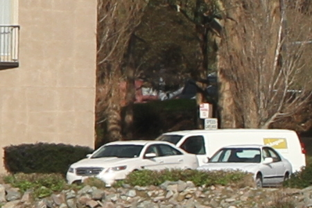

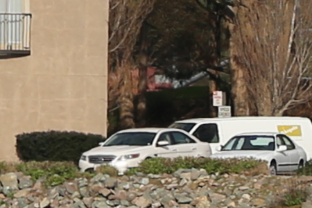

The acid test...IQ. I had read about the benefits of full frame vs. crop, but this was my first chance to test the claims firsthand. I used my sharpest zoom, the 70-200 2.8 ii, as my test case. I shot at 2.8 and f/8, trying to frame shots equivalently (100mm for the 7D, 160 for the 6D). What I found was that the 6D IQ for equivalently framed shots was indeed better, but not night-and-day better. (Given that I'll continue to use my 7D as my primary body for sports and birds, that's good news Samples attached below for f/8 f/2.8 results were similar.

The shot, with the 7D.
  Canon EOS 7D    102 mm    f/2.8    1/4000 sec    100 ISO    0.0 EV
Close crop, 7D, near the edge of the frame.
  Canon EOS 7D    102 mm    f/8.0    1/500 sec    100 ISO    0.0 EV
Same image, same aperture, equivalently framed, 6D
  Canon EOS 6D    155 mm    f/2.8    1/4000 sec    100 ISO    0.0 EV
Same close crop, 6D
  Canon EOS 6D    155 mm    f/8.0    1/500 sec    100 ISO    0.0 EV

After looking at the post, the cropped images from the 6D and the 7D look closer to each other in the post than they did on my screen. Perhaps the result of downrezzing them to 900x600 MP for posting.

^ - they look pretty close to me.

You are not going to see significant difference between ISO 100 shots in good light, especially comparing 18 and 20MP cameras. I don't think the 6D would really start to outclass the 7D until you compare low light and higher ISO images, especially if you need to lighten lower mids and shadows.

Can't see any difference b/t the two close up images above tbh. High ISO is where the 6d will pull away from the 7d. But everything else I think it will be close while 7d will offer more AF options and CLS capabilities.

tshore -- I also see little difference between the two samples in the cropped examples. But I find both slightly unacceptable compared to what I'm used to seeing in fine details. It looks like you shot the original images as jpgs, then converted/resized as jpgs again, resulting in a lot of smoothing of details and large areas of what should be subtle tone changes. I'm used to viewing RAW, making adjustments, then output as jpgs with sharper details and rez.
Were these originally RAW files? If not, that would go a way toward explaining why the two looks so similar, compared to what I see in my photos and many other photographers posts here on FM.
If you were shooting RAW, are you using DPP to process? I notice it does a lot of automatic smoothing of such areas as the building and shrub in front of it. Or was it LR4?
I'm not being critical of your gear -- I think it is great and you made a great choice. I'm just expecting a little more clarity.

BTW I'm finding my shots pin sharp even jpg with bags of detail (shooting neutral picture style).
Jan 07, 2013 at 07:24 PM
Gunzorro
p.1 #20 · New 6D! First impressions
Rob -- Yes, all your pictures have looked very sharp.
Perhaps the smoothing and detail loss is DPP (window frames for example -- loss of rez, sort of trying to make sharp straight lines there, but clumping).
