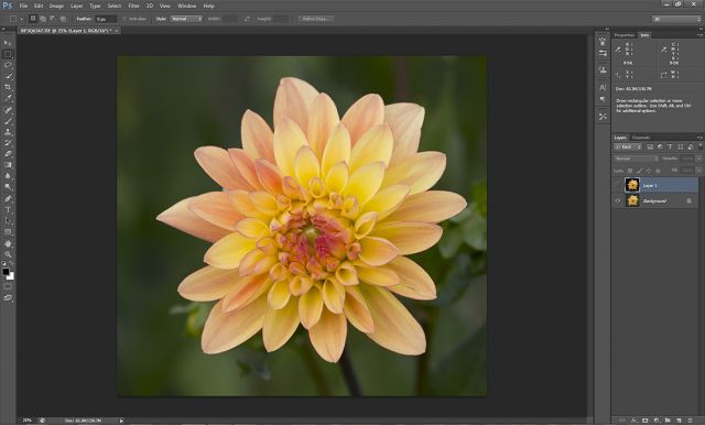

p.1 #2 · Layers and Masks explained
Here I clicked on the eye icon and now that layer is invisible
Dec 29, 2012 at 10:27 PM

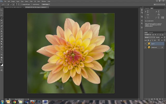

p.1 #3 · Layers and Masks explained
So I clicked on Layer 1, from here on out we will be working on this layer. I then select the flower and invert the selection by pressing shift-ctrl-I so now the background is what is selected.

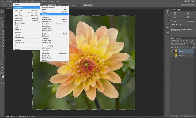

I’m now going to reduce the exposure on the background. I go to the menu and select Image-Adjustments-Exposure.
Dec 29, 2012 at 10:28 PM

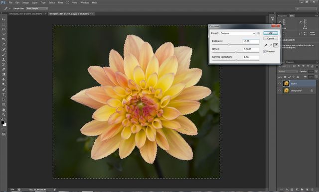

Tim Kuhn
p.1 #5 · Layers and Masks explained
I then move the exposure slider to the left bringing the background down 2 full stops.

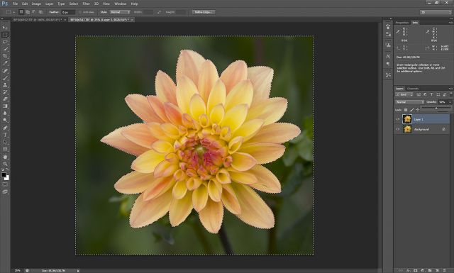

Tim Kuhn
p.1 #6 · Layers and Masks explained
I may like the background now and that would be the end of the work on this layer but if that is the case why would I bother to use a layer? This is where the power of layers comes in. No matter what I did on that layer, exposure, burn, screen, whatever I can now go back and adjust the opacity of my changes. Look in the upper right of the Layer Palette and there is an opacity slider. In this case I pulled it down to 50%. So now the background is effectively only 1 stop down. Imagine you have many layers open and some of the changes made on one layer make the changes you made on a different layer look like too much. You can go back to the offending layer and back off your changes using the Opacity slider. That is a very powerful tool and worth understanding.
Dec 29, 2012 at 10:29 PM

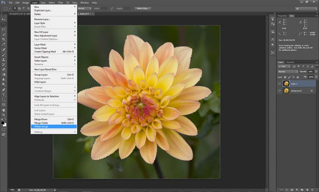

p.1 #7 · Layers and Masks explained
Now I’m done with my layer I have a couple of choices about how to save this. I can save it as a PSD or TIFF file and keep all of the layers. As you can imagine that creates a fairly large file. I tend to not save them in that fashion but there are times when you may choose to do just that. The other method is to save it as a JPG, if you want to do that you can’t keep the layers. So then you have to merge them together, no worries that’s easy. I go to the menu and choose Layer-Flatten Image. That combines all the layers together. I then just save the image.

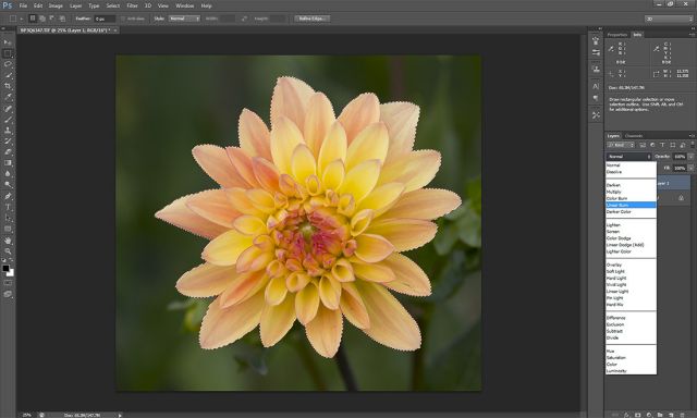

So now let go through a simple example of using Masks. Masks are really a simple concept, think of them as opaque covers. The usual flow is to apply a change, such as linear burn, in a greater degree than you think is necessary. You then use a mask to hide your changes, grab a brush and erase the mask using an opacity less than 100%. This way you can apply subtle controls to the degree of your change. I hope the following will help to illustrate this.
I opened the flower image, hit ctrl-j to create a duplicate layer. I make sure that layer is highlighted and then select just the flower. I then go the dropdown at the top of the Layers Palette and select Linear Burn.

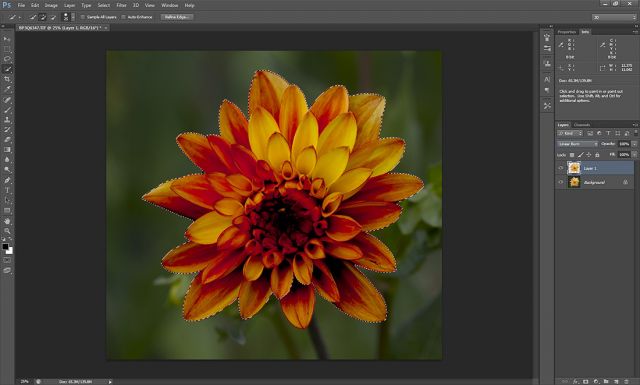

p.1 #9 · Layers and Masks explained
That results in the following image. I don’t want the whole flower burned that much so there are a couple of things I can do.

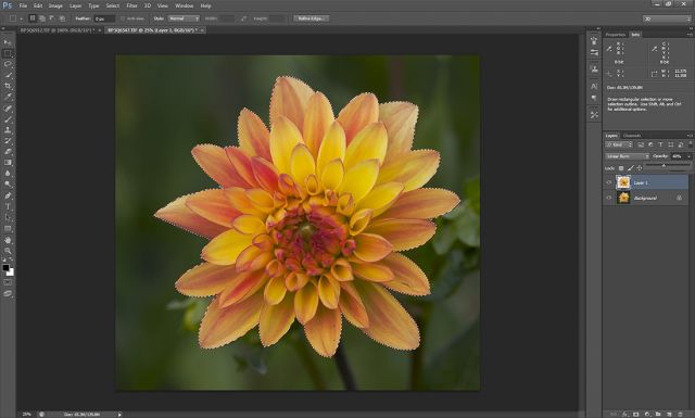

p.1 #10 · Layers and Masks explained
I can do like I did in the Layers section above and grab the opacity slider and knock it down a bit. I did that here; I brought it down to 40% opacity.
Dec 29, 2012 at 10:30 PM

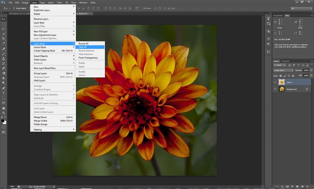

p.1 #11 · Layers and Masks explained
That works fine if I want to apply the same level of burn to the whole image but if I want to be more selective I can use a mask. I’ll go back to the 100% burn image. Then I go to menu Layer-Layer Mask-Hide All.
Tim Kuhn

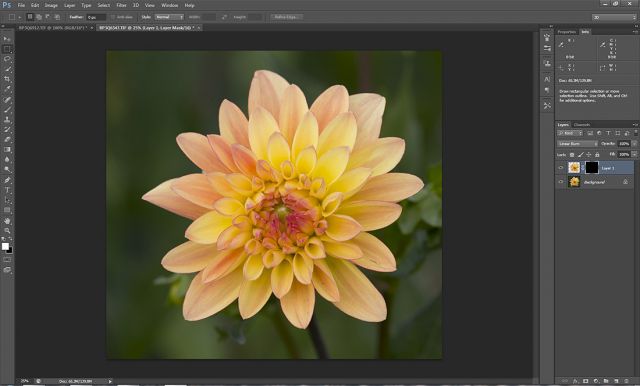

p.1 #12 · Layers and Masks explained
Now it looks like I never applied any linear burn. It’s still there but it is hidden by a mask. The mask is hiding the burn 100%.
Dec 29, 2012 at 10:31 PM
Tim Kuhn
p.1 #13 · Layers and Masks explained

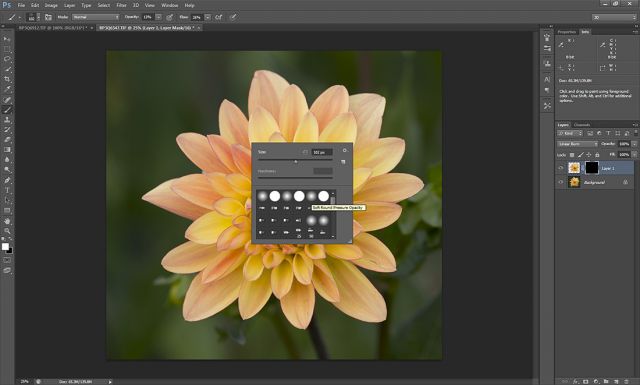

I want to remove some of the mask in order to unhide the burn. So I hit B to give me a brush. I then right click the image and the brush selection menu comes up. I choose a soft round brush, fifth in the top row shown. If the diameter isn’t what you want us the [ key to make it smaller and the ] key to make is larger. Yes there are other shortcuts but I’m keeping this simple so I won’t confuse things with more options. You also want the brush to be white not black. Look in the toolbar menu on the left of the image below. On the bottom you'll see an icon that is a black square and a white square. Hit X until the white square is on top.

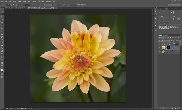

p.1 #14 · Layers and Masks explained
The brush by default is 100% opacity and flow; look at the top of editor under the menu bar is the tool details bar. In this case it is telling me that the brush mode is normal, the opacity is 100% and I have backed the flow down to 46%. Think of flow like water in a hose. You can get things just as wet with a low flow as high flow, it just takes longer. We usually want to do things subtly as opposed to grossly when editing. So I chose 46%, if I brush it once I remove 46% of the mask. If I hit it again I remove 46% more, this gives me lots of control.
Tim Kuhn
p.1 #15 · Layers and Masks explained
I highlighted the area that I brushed in the image below. If you look carefully you can see subtle differences in the level of burn within the dotted lines. Now if I thought this was too much remember I could go to the layers opacity slider like I did above and lessen the amount of change.

Nice tutorial Tim! On the mask, does it matter what color your brush is when painting with it? I know when I copy and paste an image into a layer, I can use a black or white brush to reveal or hide the underlying layer. Wondering if the same is true with the masks.....
