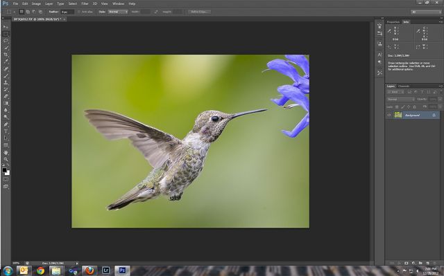

I was chatting with a forum member about Noise Reduction (nr) today and I got the idea to put a really easy tutorial that covers the very basics of nr using Photoshop. I figured there are lots of new members who may not know certain techniques. The screen shots here are from CS 6 but I have been using the same techniques since CS 3.
Feel free to ask questions
Tim

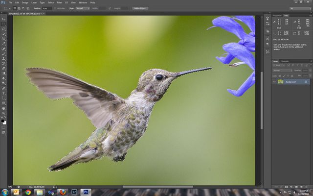

First open the image and crop if needed. Then select the subject using whatever method you are comfortable with. Then hit shift-ctrl-i to invert the selection. Or go to the Select menu and choose Invert. This make everything selected EXCEPT the subject.

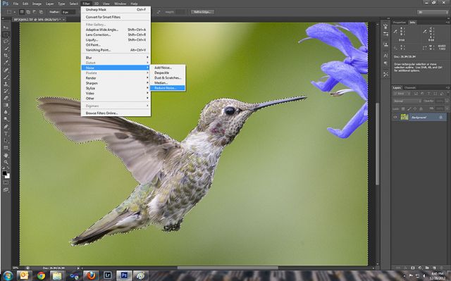

Then go the Filter menu and select Noise - reduce noise

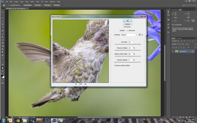

You then get the following dialogue box. Move the sliders to the values as shown and hit OK
Dec 28, 2012 at 10:07 PM
Tim Kuhn
p.1 #4 · Easy Noise Reduction
That should blur the noise to a smooth background. If it needs more, hit it again with the same noise filter. Better yet create an action that does this step and assign a hot key, that way you select, invert, hit the key as many times as needed.
That removes the noise from the background. Now if you need the noise removed on the subject, invert the selection again. shift-ctrl-i. Then run a plugin such as Noise Ninja or Topaz Denoise or some other plugin that allows fine tuning and remove just as much noise as needed without loosing too much sharpness.
