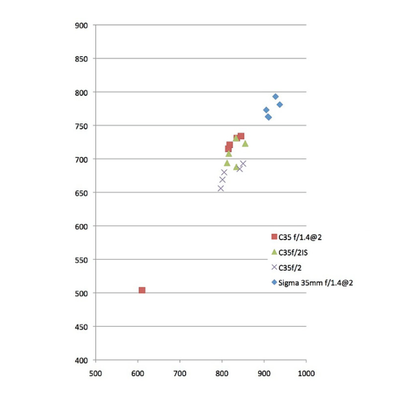

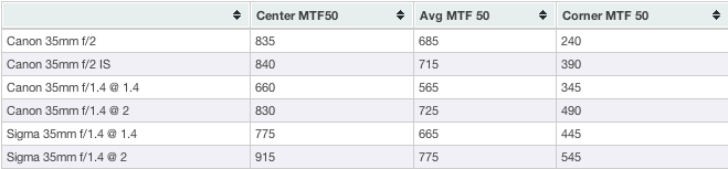

Canon 35mm f/2 IS resolution test
Roger Cicala just posted a resolution test of the new Canon 35mm f/2 IS and compared it with the Canon 35mm f/1.4L, Canon 35mm f/2 and the Sigma 35mm f/1.4.
Here is an excerpt:
"The new 35mm f/2 IS and the classic 35mm f/1.4 L do much better in the corners, with the 35 L (stopped down to f/2) clearly better than the new f/2 IS. But the Sigma does better than any of them."
Read the entire article titled: Another 35mm Lens for Canon

p.1 #4 · Canon 35mm f/2 IS resolution comparison
So if Sigma can do it, so can Canon. What is the deal?

I looked at Photozone single lens copy test results for Canon 35 f/1.4 vs Canon 35 f/2 classic, both tested on Canon 5D Mark 2. At f/2, the results are:
35 f/1.4 center 3629 edge 1685
35 f/2 center 3122 edge 2516
So, the f/1.4L has great center performance but AWFUL edge performance even when stopped down to f/2. The classic f/2 lens has much better edge performance.
Roger's f/2 results are:
35 f/1.4 center 830 corner 490
35 f/2 center 835 corner 240
Here, both lenses are equally good in the center but the classic f/2 demonstrates horrible edge performance.
So, what can we conclude from the above differences? Testing methodology matters or that LensRentals only has bad copies of the classic 35 f/2?

alundeb
p.1 #9 · Canon 35mm f/2 IS resolution comparison
Curvature of field?
Photozone in their method refocus for the corners. I don't think LensRentals do, but Roger Cicala will probably be here in a minute to answer that
http://www.lensrentals.com/blog/2012/09/why-arent-the-damn-numbers-the-same
Dec 14, 2012 at 11:53 AM
RCicala
p.1 #10 · Canon 35mm f/2 IS resolution comparison
alundeb wrote:
Curvature of field?
Testing methodology for certain. I don't refocus for corners, we use the best center focus and take the corner results as they lie.
There's also testing distance (small variable) and chart differences (depending on what you analyze, corners may be 85% to 95% of the way to the actual corner. Finally the 4 corners are never exactly the same - you could use highest, lowest, average, for that value. I use average, not sure what they use.
Bottom line - this is why we need to look at several peoples reports and balance them to get an idea of what is reality. I usually end up putting out the first report, just because I get early access. But then I'm like everyone else, looking to see what others say to confirm or modify what I saw.

p.1 #12 · Canon 35mm f/2 IS resolution comparison
The charts somewhat confirm why I continue to be so happy with the performance of my old 35mm f/2 lens - small and humble, but a fine performer.
Also, the chart demonstrates that charts don't tell the whole story! Something I know very well from using the 35mm f/2 (old model) quite a bit is that the very furthest corners can be a little soft - though usually not enough to even notice. However - and what the chart does not tell us - is that the drop-off in sharpness between the measured center point and the measured corner is not linear. Instead, the 35mm f/2 remains very good until just before the far corners, at which point the decline in sharpness kicks in. Other lenses - some of which I own or have owned - showed a decline in sharpness that is more gradual and starts further into the frame.
Such charts that inform us of performance at two points in the frame (center and corner) provide a lot of interesting information, but there is also a lot that they don't tell us. They are a bit like reporting "the weather in the United States" by telling us what it is like only in Anchorage and in Dallas.
And, as always, we are reassured by this report that there are a whole bunch of 35mm primes for our Canon cameras that produce truly excellent image quality, and that the choice among them is more about things like cost, size, intended use, and so forth... than about the single data point of "sharpness."
(Of course, as always, it is smart to not assign too much significance to the results of a specific test, especially given the history of tests that can be quite different from one another. It is also really important to recognize comments like "A kicks B's butt" for the hyperbole that they represent.)
Dec 14, 2012 at 05:42 PM
gdanmitchell
p.1 #13 · Canon 35mm f/2 IS resolution comparison
Actually, I think this is corner performance, not "edge" performance. See my previous note about the nature of the roll-off in sharpness on the old 35mm f/2.
