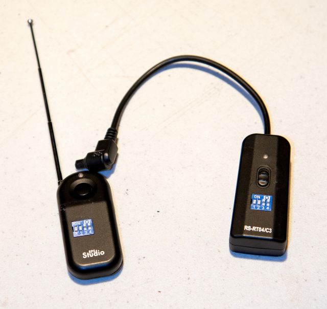

Attached is an image of the remote system. I'll try to get a shot of the backboard set up this weekend. On the 24 second clock which is new this year it says 'Daktronics' if that means anything to anyone.

I'm going out on a limb here and say that it's probably a combination of the cheaper trigger and metal/interference on the new goal. If you are going to do remotes in a basketball arena, invest in pocketwizards.

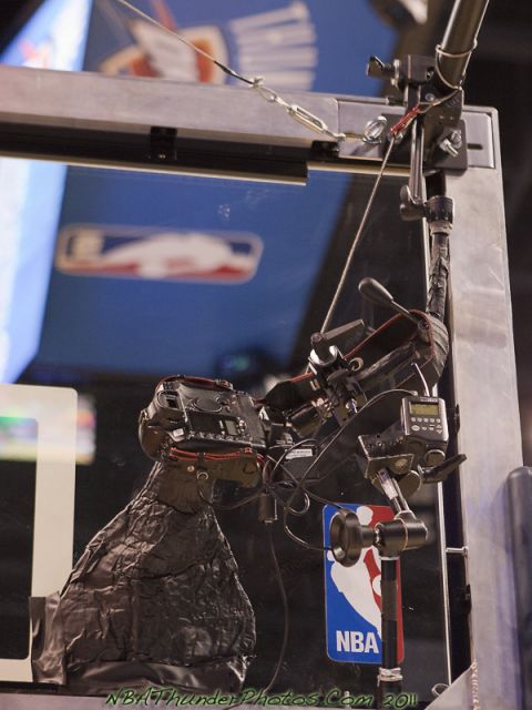

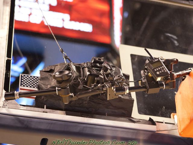

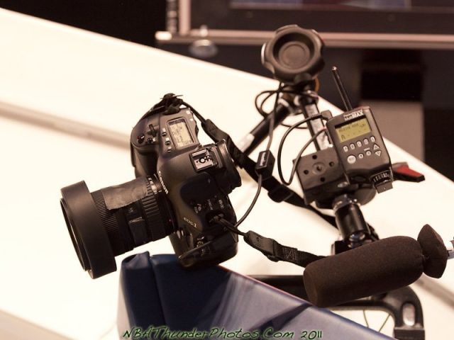

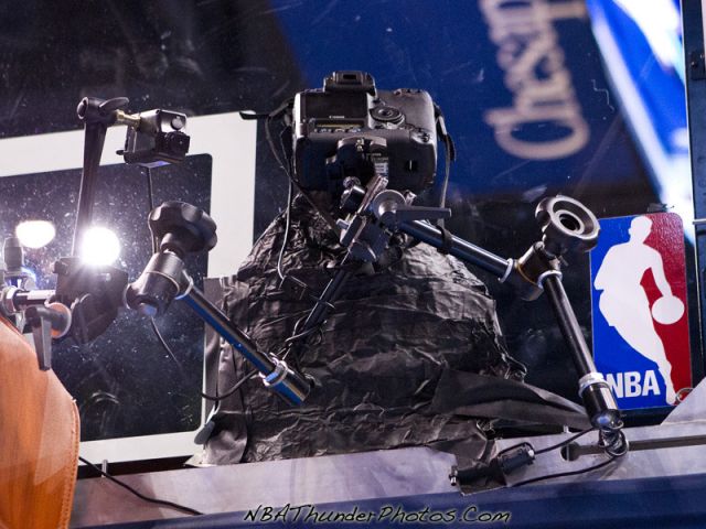

p.1 #14 · Backboard camera issues
Just a few remote setups.
Dec 14, 2012 at 03:59 AM
