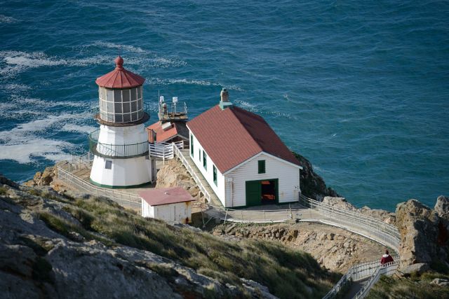

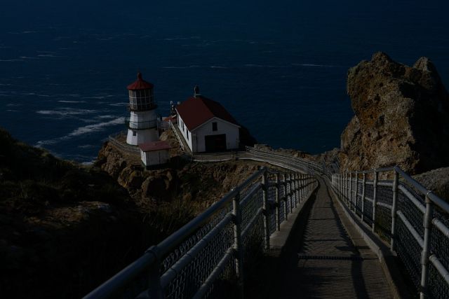

Something is really weird with my D800E or the 70-200VR II. Same settings take minutes apart and the exposure was different. Just test it again in my hotel room and the results are the same.
Have not done anything except viewing in NX2 and converted to jpeg 900px.
70-200 VR II
  NIKON D800E    200 mm    f/10.0    1/1250 sec    100 ISO    0.0 EV
50mm f1.8G
  NIKON D800E    50 mm    f/10.0    1/1250 sec    100 ISO    0.0 EV

Different lenses and different focal length. The D800E/70-200 combo looks fine to me. The 50 1.8 is underexposed

p.1 #3 · two lens different exposure?
Check the aperture lever on the 50. Make sure it's not bent or broken. Can you move it manually and see the aperture leaves moving? Looks like it's not opening properly. If the lever is not engaging the actuator in the camera, then the lens stays at f22.

p.1 #4 · two lens different exposure?
I was afraid that something is wrong with the 70-200 because my 14-24 and the 300mm af-s are behaving the same as the 50mm. Just test shooting out the window with all four lens. The 70-200 has a histogram that is mostly toward the right, where as the others are mostly in the middle and to the left just a little. Really weird..

p.1 #5 · two lens different exposure?
Neddie, I checked the little level and noticed when I push the it to the right, the 70-200 does not go all the back to the left like the others. This may be the problem. I can just bend the level a little to fix it or should I send it in?

p.1 #6 · two lens different exposure?
Sounds like it's binding on something inside. If it looks straight, the same as the others, then the lever is OK but something else is wrong. I'd send it in.

p.1 #7 · two lens different exposure?
It is difficult to believe that the 70-200 is really at f/10. If you assume an EV of 15 at ISO 100, the shutter speed would be about 1/250 at f/11. At 1/1250 the exposure would be at least 2 stops under.

p.1 #8 · two lens different exposure?
I agree, those rocks are pretty seriously out of focus for f/10.

p.1 #9 · two lens different exposure?
Check if the 70-200's aperture closes when you shoot, or with the preview button. 1/1250 is about right at ISO 100 f/2.8.
