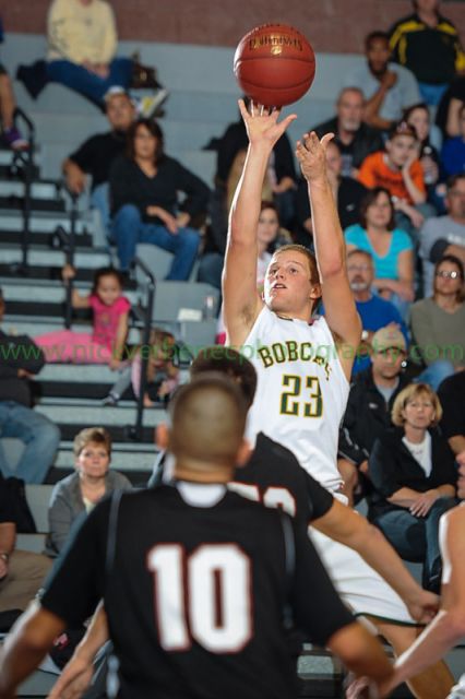

This year I upgraded my gym lighting set up. Last year I had a speedlight on each side of the gym. This year I am going to try an Einstein on one side, and a speedlight on the other side. I would love to try and get another Einstein on the other side of the gym, but the way its configured, there is no way to do so.
Its a work in progress. I still have to work out the kinks and see how I like things. My biggest thing is getting the Einstein and speedlights the same temp and some-what balanced, power wise. These shots were with the Einstein behind me and the speedlights giving a bit of a rim light to whatever I was shooting.
#1
  NIKON D3    85 mm    f/4.0    1/200 sec    1000 ISO    0.0 EV
#2
  NIKON D3    155 mm    f/3.5    1/200 sec    1000 ISO    0.0 EV
#3
  NIKON D3    200 mm    f/4.0    1/200 sec    1000 ISO    0.0 EV
#4
  NIKON D3    140 mm    f/3.2    1/200 sec    1000 ISO    0.0 EV

the backgrounds are killing me - they are bright enough and clear enough they distract from the players

In 2, it seems you don't have the strobes high enough power over ambient as evidenced by the blurred ball. Was this intentional?
