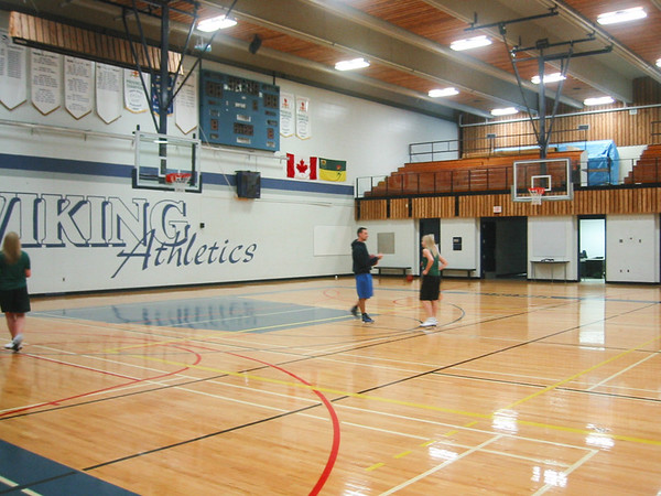

I would like to try strobing my local HS gym for basketball again this year. I tried last year with my 4 AB800's mounted in the corners and bounced from the roof. I wasn't terribly impressed with the results.
Below are some pictures of the gym. I think the bouncing from the roof wasn't great due to the color/design/layout of the roof. So I was thinking this year to maybe go direct or try bouncing off the end walls.
Having never tried direct or bounced from the end walls, I am looking for some advice.
How would some of you who strobe regularly strobe this gym? I have access to mount the strobes pretty much anywhere I want.
Take note of the one end wall that has a large metal door running about 1/3 of the wall length.

Your ceiling definitely makes bouncing less effective but I have always shot direct rather than bouncing. The color, contrast is just better than bounced.
I just use 2 Einsteins. I use light stands along the baseline outside the line of action and I point the strobes towards center court. Here are a few shots with my approach.

A combination of wall and ceiling works well. If you are going to try to use the walls only it would be nice if you can utilize the corners to get some cross bouncing going on.

I don't think that gym looks that bad and I'm surprised bouncing didn't work. I bounce off a gym that has white ceilings, but there are large beams and HVAC units up in the rafters/beams that one would think would be a mess. I just bounce and let 'em do their thing. You might be surprised how far light will bounce around.

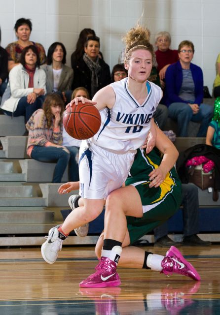

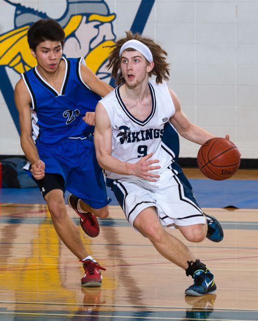

Here are a couple of pictures from last year. (First and only 2 games I have strobed) One from each end of the court. These are a couple of the better shots. What I am not crazy about is how much light is in the background. It seems bouncing off the ceiling kinda lights everything somewhat. And I am not crazy about the shadows. Guess I should shoot tighter or find better spots to shoot from (lower?).
I would prefer either a bit more ambient or a much darker background. I am thinking direct strobes may create the darker background. Maybe I just need to adjust my settings?
Is it better to have the strobes mounted higher or lower? Standard reflectors or long throw?
  Canon EOS-1D Mark IV    95 mm    f/4.0    1/320 sec    800 ISO    0.0 EV
  Canon EOS-1D Mark IV    90 mm    f/4.5    1/320 sec    800 ISO    0.0 EV

What does the ambient meter and how does the light look? The lights look like HF fluorescent lights which are great in that they don't cycle very much at all.
John
Nov 29, 2012 at 03:11 AM
rdalrt
p.1 #7 · Strobing a gym - advice/opinions wanted
Ambient is about 1/400, 2.8, 3200. Correct about the HF fluorescents. When I do shoot ambient, there is very little color shifting from cycling.
