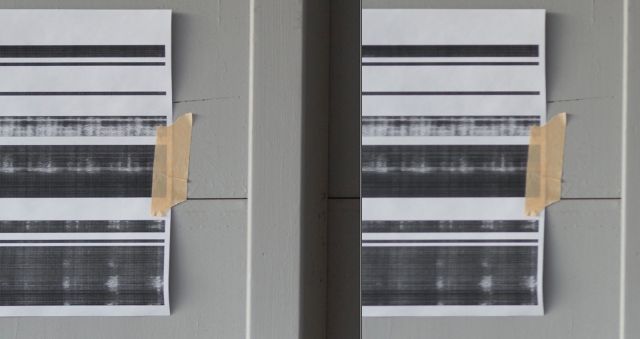

I tried exchanging the d800 and the second camera looks almost identical to the first. Now I'm trying to figure out if the focus variability is just within the margin of error and I'm being overly sensitive, or if it's the same issue again. Here's a quick example of two consecutive shots from the left-most AF point. The paper is the test pattern that overlaps the left AF point (yes, the laser printer I used needs more toner). Those shots look close, but clearly not the same. The masking tape with handwriting is below the center target. There you can clearly see a much greater variance.
Am I going nuts, or is this the dreaded left AF issue on a second camera in a row? I can post center and live view photos too if anybody would like.
Thanks!

Months ago when this first appeared, the left AF issue was never described as a sometimes thing. People were experiencing an issue with every shot. And the issue was glaring.
Nov 25, 2012 at 05:08 PM
recdaco
p.1 #8 · D800 Left AF inconsistent
Thanks, Roy. I'd consider the difference between the tape to be pretty glaring, but it is certainly an intermittent issue.

Compare it to the right. If they are the same then your camera is fine. The outer AF points will never be as consistent as the center.

I agree! and ussually the left AF issue is a total blur at 100%
