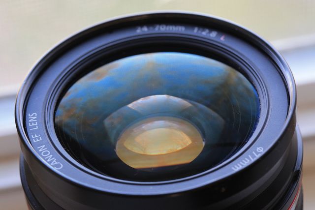

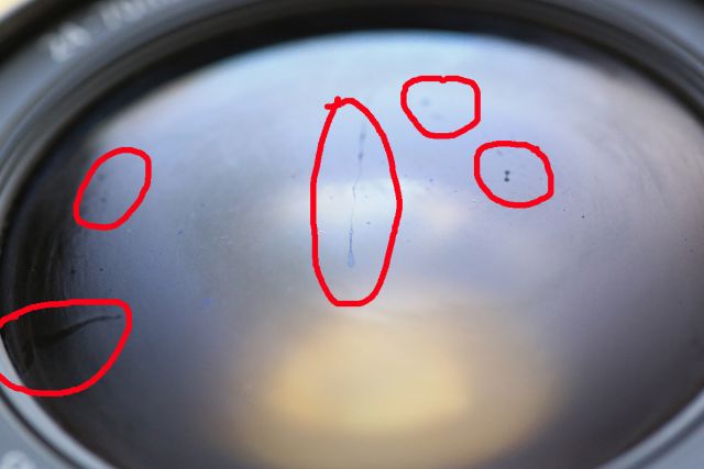

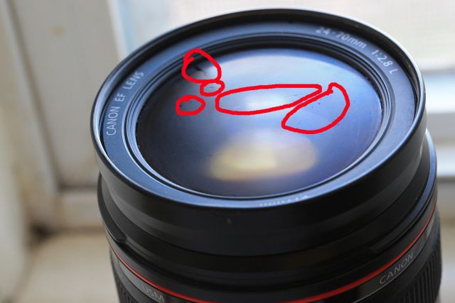

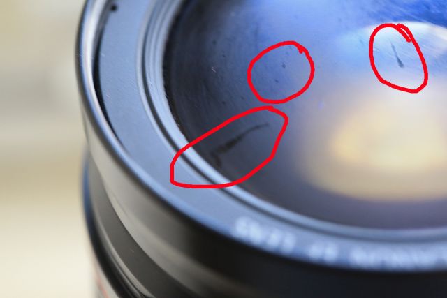

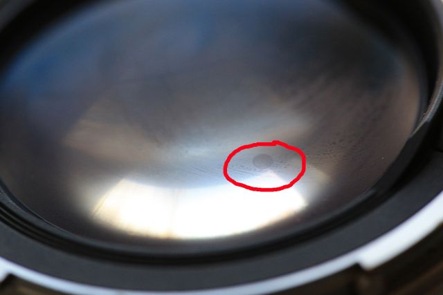

I just did a trade with someone here. The front and rear elements appear to be like in the pictures after fogging the lens up. I tried to do some basic cleaning that I normally do with all other lenses, but the smears didn't come off.
I contacted the owner to see what he thought about it. I gave him a benefit of the doubt that he didn't see it before shipping it out. So, I simply asked that I would try to buy an ROR to try to clean it off. And I wondered if he would honor a return if it wouldn't come off. My take on this was that, if it wouldn't come off, it probably affects the coating of the lens and I wouldn't want that from an expensive L lens.
Strangely enough. The guy started getting upset with me about it. He said they weren't any scratches and so I should be fine with it. And he made it sound as if the smears weren't there before and so they could have happened under my hands. And, you guess it, not a single word of apology and he refused to take it back.
He told me that it's my lens now, so I can do what I wanted.
I guess I will just try to clean it with ROR. I think it'll probably come off. But I have to say that I expected better from that particular member here.

Well that's got to affect IQ in some way, it looks like Vaseline has been smeared on the lens .
I know I wouldn't be best pleased by it

I am not sure how representative your pictures are of the reality of the front element, but if they are, then I'd say it is way past the point at which I'd consider it unfit for image making.
The smears only show up after fogging up.
I gave him a benefit of the doubt because he lives in hot zone (Florida). When the lens got here, it probably got cold from being stored in the delivery truck all night and the smears showed up right after I unboxed it.
This is how the lens looks like without fogging it up.

I have observed instances wherein fogging exposes inconsistency in a len's coating, where those inconsistencies couldn't be seen in absence of water bonding to the surface. My opinion is that rarely, if ever, can a visible front element surface defect, affect image quality. Perhaps you've seen the lenses of working photojournalists. If you doubt this, take a crayon and paint marks on a lens front element and shoot.
John Caldwell
While I partially agree with your assessment regarding the front element, especially along with this article from lensrentals.com:
http://www.lensrentals.com/blog/2008/10/front-element-scratches
I find that issues with front element can affect flares the most. So, like many others, if having a choice, I wouldn't want a lens with any sort of blemishes on the glass. Even if it doesn't affect image quality, i would definitely affect the resale value. Basically, whenever I try to sell this lens and if the marks don't come off, any potential buyer should expect me to enclose every detail of it including these blemishes. Don't you agree?
Now, rear element in the fourth picture is another story.
At this point, I'm down to 75-80% sure that the ROR will resolve this. I was 90-95% at first. But that the seller rejected to honor the return right away gives me some doubt what has happened to the lens to cause these smears. I kinda believe the original owner either 1) knew it what he's done with the lens or 2) bought this thing used and didn't check it thoroughly.

Wahoowa, it's doubtful the marks will have any effect on the image quality in actual usage. I doubt that flaring would result either, but that can easily be tested.

I'm sure the seller was caught flat-footed and had never noticed the effect -- it's easy to overlook, as your one un-fogged images shows. That doesn't mean the condition doesn't exist, I'll bet the seller didn't know, especially based on his shocked reaction and poor response. Personally, I would have done different if I were the seller.
A couple years ago, I bought a 15-85 IS on eBay, and when I got it, it had similar splatter marks (but fewer and smaller), and were very evident when I fogged with my breath. I used Singh Ray fluid to clean, but a few were permanently part of the coating. I contacted the seller, who gave me the option to return for refund or keep it and get $100 refund. I took the partial refund (knowing, like you, that the marks would need disclosing if I ever sell the lens and affect price). The good news is the marks never affected picture quality in any way, and that is one of my most contrasty and sharp lenses! I often use a lens hood outdoors to hedge my bets, but I now take it anywhere with no worries about damage or splashes!
Clean it, then take a few pictures in typical contrasty scenes, and then contact the seller again, and reference this thread. Ask for a partial refund or return. Let the person know you aren't blaming them, but the marks were there on arrival.
