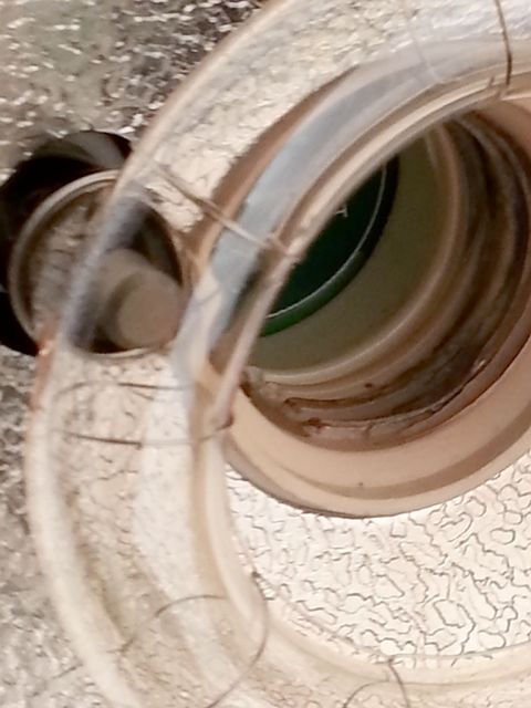

Working with elinchrom to try to figure out why the thermal protection is not kicking in. One thing that is a design flaw IMO is that the light bulb socket is plastic. Even the threads are plastic. So when it gets hot, the threads melt. I have the feeling that the plastic acts as an insulator and melts before the thermal circuitry can detect the temperature. At that point, it probably melts the leads ...
Do you have photos of the melted stuff?
Or are you just theorizing?
Nov 15, 2012 at 04:56 PM
jzucker
p.3 #5 · ARGHHHH...A 2nd Elinchrom BXRI-500 bit the dust
kenyee wrote:
Theorizing? Why would I need to theorize?!? It's in my studio !!! Yes I have pix which I sent to elinchrom. I thought I mentioned before that the first one that melted I had to remove the modeling bulb with needle-nosed plyers and a screwdriver because it had fused to the threads of the bulb.

Sorry...didn't see you mention that. Could you post them? I'm curious to see the melting. I'm amazed it got that hot from the modeling bulb to melt plastic...they usually use high temp plastic I'd think (like Kacey did w/ his BD)..
Nov 15, 2012 at 10:32 PM
jzucker
p.3 #9 · ARGHHHH...A 2nd Elinchrom BXRI-500 bit the dust
here it is. This one didn't melt to the degree that the first one did. The first one melted so badly that I had to break the bulb off and pry out the bulb's base with needle nose plyers and a flat blade screwdriver. This one came out without having to break the bulb off.

Wow...if it's that warm in there, I can't say I'm surprised the circuit board fried :-O
I'm surprised they put in a plastic socket too...

I'm now wondering if the thermal circuit takes the modeling lamp into consideration. Plastic would act as an insulator so any thermal circuit wouldn't sense the temperature the way it should. It's puzzling because in addition to allowing the sensor to access the true surface temp, a metal base would also dissipate heat and allow the fan to actually cool the modeling bulb temperature.
Doubt it.
As someone who has designed thermal circuits on my day job, you don't stick them on modeling lamp bases. It's just a sensor on board usually...usually part of one of your other chips nowadays...

As I said, the sensor on the board can't sense the heat through the plastic insulator so the insulator (lamp base) melts before the sensor can do it's job.
Air flow would push air from the back through the front usually. I suspect it's not pushing the hot air away from the socket and the flow is creating an eddy so the hot air sits there. Dum idea to put a plastic socket there no matter.
Doesn't explain the circuit board frying though...seems their temp sensor warning limit is set too low or they didn't put the sensor in the right place and it's measuring the cool air being sucked in, IMHO..
All guesswork though w/o talking to the engineers who are working on it.
