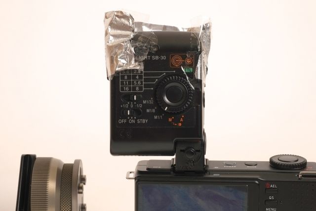

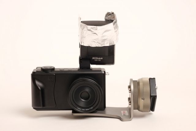

Here's what the setup looks like for using studio strobes; it works perfectly; the the aluminium foil keeps all the SB-30 light off the subject.
The next image shows a "BetterBounceCard" attached; with the aluminium foil in place, all light is directed up, and the whole thing becomes a decent diffuser for fill light.
The last image shows what real controls look like: you have a choice on the dial of 1/1 (full power), 1/8, or 1/32; then the little switch to the left can halve or double thatso all powers from 1/32 to full.
To use, go all manual on the DP2M; and remember that this camera can sync at any shutter speed!
aluminium foil blocks direct flash
BetterBounceCard attached
Simple manual controls from yesteryear
