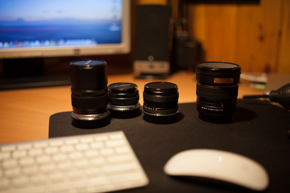

Alright, here's another test. These where all shot at ISO 1000, off a tripod, 3 shots where taken at each aperture and the best was chosen. Focus was on the middle dart. attached are links to the 100% crops.
The difference between wide open and 2.0 seems huge... no? This is a better example of the "haze" i had previously mentioned. see the detail on the darts fin.
Opinions?
Thanks!

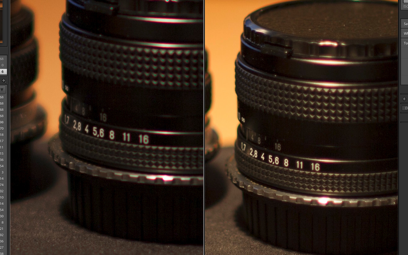

Here's one comparing my Rokinon 35mm F1.4 (right) versus the Rokinon 85mm F1.4 (left). Both at F1.4... focused on the "4" on the subject lens. Both 100% crops
Rokinon 85mm (left) - Rokinon 35mm (right) both at F1.4... distance was clsoed for the 35mm

Looks about right to me. The 85mm is not made for closeups. An ever so slight push of midtone contrast or clarity will probably improve the 85mm shot. But the 85mm is indeed a bit less brilliant than the 35mm. Probably due to CA or perhaps a bit more flare sensitivity. I don't see an issue in real life photography - this effect is likely what you see with more expensive brands too, like the Nikon 35mm 1.4 vs the 85mm 1.4 (although I never tried).
I'd suggest to go out and shoot with the 85mm - if you end up unhappy they are easy to unload at eBay. A Sigma 85mm 1.4 is the next stop then - I noticed that some stores were discounting this lens.

85/1.4 isn't that sharp wide open. It's sharp enough
though. Lots of flare with that lens (none in ur shots) I don't see anything out of the ordinary in your shots. The 1.4 "haze" may just be lower contrast from shooting at an aperture that doesn't have as much contrast, like my 90 tamron at 16 or 22. My opinion : looking at 100% isnt the best idea. the prints should look good. 85 at 1.4 not the sharpest in general I suspect regardless of brand.

I think what you are describing as haze is slightly lower contrast coupled with a bit of softness. Slight adjustments of contrast/clarity/sharpness should take care of it.

+1
The difference between 1.4, 2, and 2.8 likely not as noticeable in real world images.
