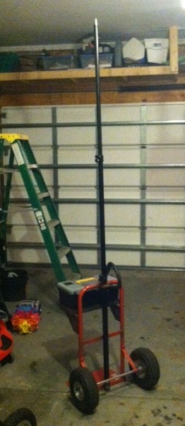

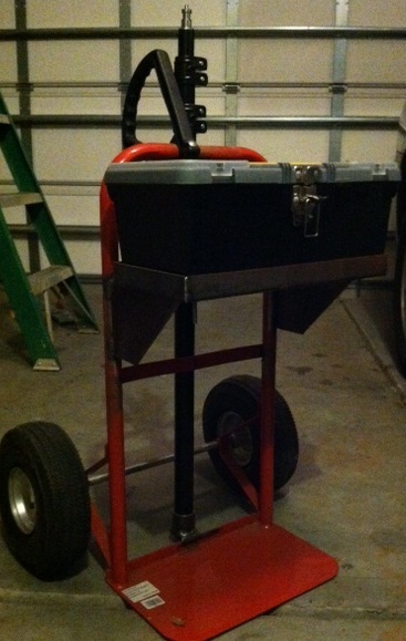

Found what I was looking for!!! I will try it out @ a wedding this weekend and let you guys know how it works out for me.
The center of mass in your rig is to high. It could be knocked down/get unbalanced easily.
You should put the battery on the bottom tray to act not like a counter weight but like a ballast.
Thanks for the input. It has not been completed yet.... I wll be adding a couple of sandbags
