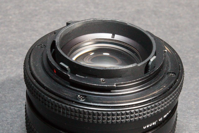

I don't have a before picture but this is what it looked like after I shaved it.

I believe that the aperture lever is the one on the right and is barely shorter than it originally was. The short lever on the left is untouched. I'm not sure what purpose the short lever serves (maybe aperture readout?).

Yes it is. When aperture is changed that lever moves. On a Contax body the DOF-preview button pushes that - and if it's just grinded to fit a Canon body it should still work on a Contax.
I have not had the 50/1.7, but what's common for many other Contax lenses is a small "fin" next to the aperture lever. Looking at the top ring it looks like something could have been grinded down there, just above the screw on the middle ring. That's where the fin usually is. Normally it is just a rectangular bit sticking out, but on e.g. the CY 100/2 it's quite a large triangular shaped thing there (that's at least what's on my MMJ version).

I was talking about the short lever on the left side, near the red dot. That one moves with the aperture ring but can't be pushed -- the aperture lever on the right can though.

Sure, I was just trying to elaborate that there are other protruding things too. Including trying to pinpoint something probably missing (grinded off) in surf-monkeys image.
