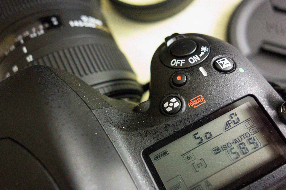

I have a D600 and wanted to find a set up that works for UWA. I am testing a 12-24 II sigma lens and it will not connect, or at least shows 0 for the aperture.
Any ideas on this?
Here is what I see….

Probably a stupid question David, but have you tried cleaning the lens contacts?

Wow. Sigma have achieved the impossible
DOF must be insane on that lens.

Seems to me that Sigma has had problems in the past with firmware mismatch between their lenses and newer Nikon bodies. You'll probably end up sending the lens to Sigma for firmware upgrade..

That was the firs thing I did. Well that and checked that the aperture lever was not stuck or bent.

I subsequently tried it on my D700, and D7000. It did the same thing.
I am returning it and trying another as I really want the 12mm FF lens.

Work fine on my d800, D3, D7000 and D4(friend). My neighbor borrow mine for his new D600 work fine as well

I had a 50-500 sigma that did the same thing, something electronic. I also made sure the contacts and lever were fine.

Thanks for that. I think I just got a bad one.
