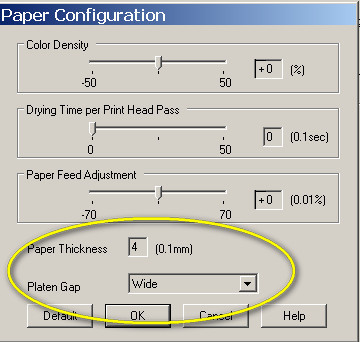

the platen gap and paper thickness is set in the printer driver itself, usually under some heading like Paper Handling (thats on a Mac; no idea on Win). You can try decurling the paper and there is a method that some use that includes lightly misting the back of the paper w/ water (pls verify that before you waste a $$ sheet )

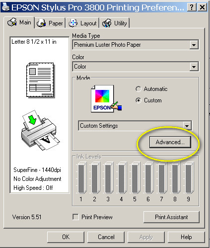

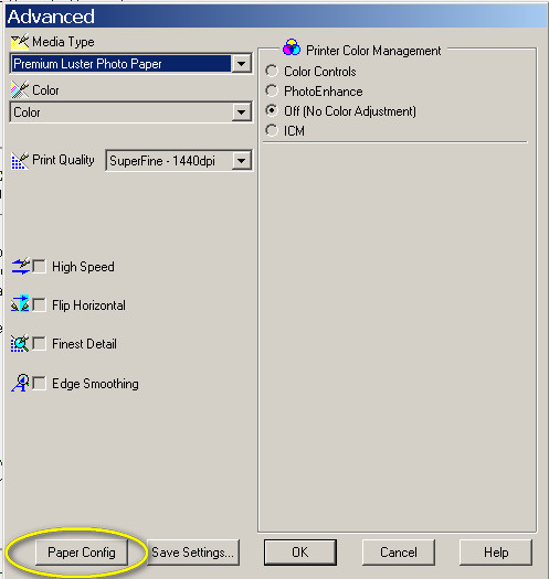

p.1 #7 · Epson Stylus Pro 3800 question
Ute:
Here are images of the English Windows version of the driver.
bob snow
