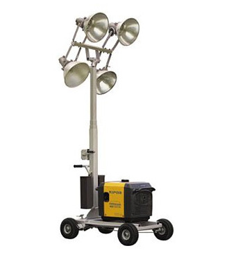

I think you need one of these, or maybe two:
Good one, art supreme!! +1

@Art, I'd laugh, but I shot at one of the "Christian" schools up in the big city (150 miles N). Nice grass on the field but it was lined with construction lights mounted on portable generators. The light was a ghastly hue (as you well know) and I (and everyone else) sucked diesel exhaust for the 2+ hours. Not a field I ever want to go back to.
