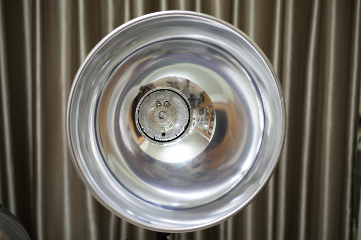

phuang3
p.1 #11 · Bron reflector on Elinchrom
I just built a DIY PAR Reflector for Elinchrom. Here are some photos if you're interested.
At different angle with 600RX
I used epoxy to attach the mount and reflector. Some epoxy is spilled out, I should make it look better.
DIY Maxilite reflector
At different angle.
Some thoughts. The authentic PAR Reflector from Broncolor is a much smaller reflector. However, this is the smallest shining reflector I could find on the market.
