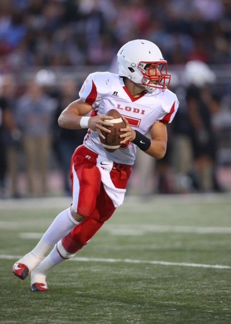

I've been waiting to shoot football with my 5D3 since picking it up last May. I shot some ISO 50K that turned out pretty nice with some minor tweaks & NR. But lets face it, football is more of a challege.
I normally flash my night football (MaxPreps jobs). Las season my night setup was a 1DS3 with a 400 2.8 & a 580ex2 on a DIY bracket mounted low on the monopod. My normal settings were ISO 800-1000, 250 @f/4 manual....
Last night was the first time out for night football. I started at ISO 6400 at around 800 @ F3.5. I then went to ISO 10K @ 1000-1250 F/3.5 or so. I was really pleased with what I got. I was really pleased with the low-light focusing of the 5d3. I have a couple shots where I tried using a "fill" flash. I used highspeed sync, kept all my settings the same just to see if it was worth it. I found I was able to flash a few frames in a row where before, I only got one shot out. PP was done in CS5 with moderate NR using the CS5 noise filter.
Take a look and let me know what you think.
  Canon EOS 5D Mark III    400 mm    f/3.2    1/800 sec    6400 ISO    0.0 EV

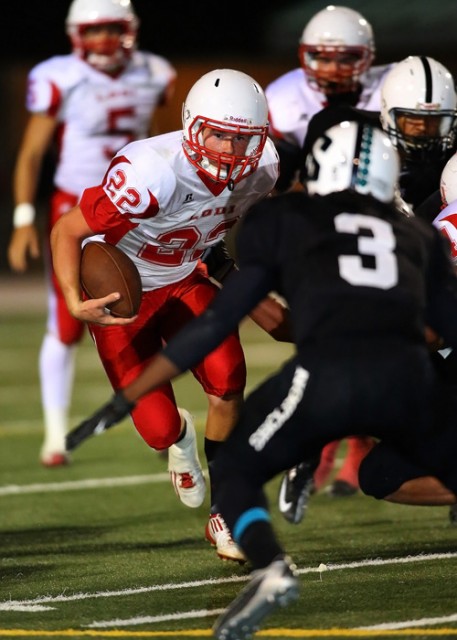

Here is one where I used the "fill" flash. The benifit I saw was no huge shadow caused by the low flash position, but the flash did fill the player's face a tad.
  Canon EOS 5D Mark III    400 mm    f/3.2    1/1000 sec    10000 ISO    0.0 EV

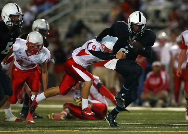

Here is the next shot in the sequence with no flash fill

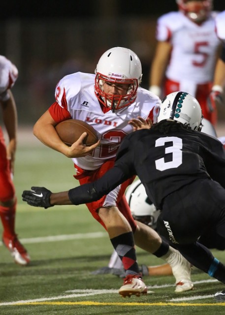

This one is also flashed, I think the nr is a little high on this one One thing I don't miss is the ghosting I used to have to watch for.
  Canon EOS 5D Mark III    400 mm    f/3.5    1/1250 sec    10000 ISO    0.0 EV

Ralph....these look great to me. On #2 and #3....for ISO 10000, those faces are spot on and sharp. Nice work.

Not sure of it is my iPad, but what is happening in the first shot with the word Lodi on his chest looking blurrey yet the other parts seem aparently fine?
guy
Sep 02, 2012 at 04:25 PM
Ralph Thompson
p.1 #10 · 5d3 first crack at night football C&C appreciated
Guy,
I think its a combination of the double stroke on the font on the jersey and the down resing of the file. It was sharp on the original.

Nice job Ralph. I don't know how everyone else sees it, but for my taste, I much prefer images 1 & 3 without flash. I think MaxPreps needs to take another look on their policy regarding "must use flash" because with the newer bodies there are some super nice results I have seen lately without flash versus with it. Just sayin'.
Billy-
Sep 03, 2012 at 12:11 AM
Ralph Thompson
p.1 #14 · 5d3 first crack at night football C&C appreciated
Billy,
MaxPreps has taken a look at the new generation of cameras and does consider non flashed work. I shot about 80% non-flash. When I got enough images is when I started playing around with the flash. I liked it on some, didn't like it on others. What I hate doing is red-eye repair in post. Even with the little "puff" of light I was trying to get, I was still getting some redeye not a lot but some...

How low is your flash mounted?
From the shadows in picture #2, I'd guess not low enough, especially if you're getting red-eye.
An easy to remember rule-of-thumb is 1" of separation for every foot of subject distance (or the tangent of 5 degrees if you prefer math over rules of thumb).
So if a player is 10 yards away (i.e. 30'), then you'll need then flash 30" away.

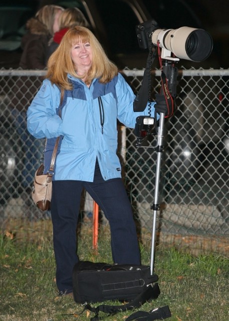

Here's a photo of my set-up... Only the body has changed... This was when I shot a 1ds3... Yea, I know the red-eye math, But....
My lovely wife modeling my night football rig...

If you just mount your speedlite upside down, that will give you another 8" of distance from the lens
