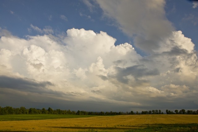

Can I get some judgement on how I did with my PhotoShop'ping?
I just shot this within the hour.
Here is a link to the RAW file: http://dl.dropbox.com/u/90191525/2012-08-27_1DS34360_EOS-1Ds%20Mark%20III_200_24_16_320.psd
If you can make it better, please let me know what you did.
Thanks and regards......Pete
  Canon EOS-1Ds Mark III    24 mm    f/16.0    1/320 sec    200 ISO    0.0 EV

This is a PSD not a raw. I did open it in photoshop and it is full size so I was able to see stuff not so visible at web size.
Lots of dust spots, noise in the sky and dark areas, and vignetting upper right corner. (visble here as well). There is also some banding going on.
I also have a 1DS-mk3 and when I shoot 24, I seldom go over f8. I would have done this at f8, ISO100 and had all the dof I required and less noise and fewer dust spots.
At web size, it looks fine overall. I do think I would crop the bottom shadow and the top to eliminate the vignette. The clouds look nice, I don't see any blown areas.

Thanks Ben for your comments. I'll do as you suggest, and I noticed that there is a lot of dust spots. I'll have to get that cleaned.
As for the raw file, I did originally upload the .cr2 file, then I noticed the dust spots, I tried to eliminate some of the worst ones.
Thanks again for your comments.....Pete

Ben pointed out the vignette and dust spots, so you are on it!
I think you did a great job preserving the whites in the clouds and a natural look to the sky with accurate blues. Not sure, but I think the field and trees could use a bit of sharpening.
Nice comp. A tranquil scene realistically rendered.

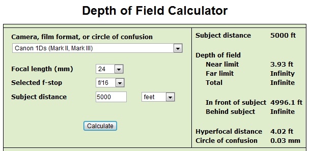

But with what you said about the trees and field, which I agree with you by the way, I had the aperture set to F16, so according the the Depth of Field calculator, everything from 4ft to infinity should have been in focus.
No way those trees are closer than 4ft So I am confused.

Where did you focus? According to the calculator, 4 feet ought to have been your focus point. But when I use this calculator, I set CoC at .015 which would get you a bit further out. No matter, as you said there was nothing that close which is why I said use f8.

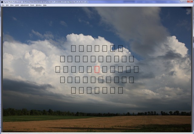

The focus point was pretty much dead centre of the picture.

By the way, this is far from hyperfocal. If you want to use the DOF master to find DOF here, change the focus value to 10000 feet or so. That's as good as infinity. Your cloud was probably at least a mile, so you could use that value.

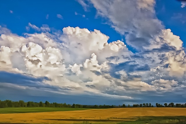

I actually over-did-it-a-bit to show you how playing with the clouds can totally change your image... I opened in LR4; Custom WB off clouds; Opened in Nik Color Efex Pro and did a tonal contrast on sky; Opened CS5 and did a shadow / highlight adjustment; Ran through Topaz Simplify / oil paint; Blended image into original @ 15%... I absolutely love Topaz & Nik...

Now that is something different! Isn't software amazing!
Is Topaz a Lightroom add-on or can it be added to CS5? Or is it a separate product?

how did you get your focus points to show up on the image on your screen...just curious, I would love to be able to see that on screen when I shoot multiple frames to stack for focusing.

Travis, this is a feature of Canon's DPP, Digital Photo Professional; open a photo and click Alt-L, that brings up the focus points.

Awesome, Thanks, I will keep that in mind. I don't use DPP much, but have it installed. I will use that when stacking next time...still getting into that kind of thing.
