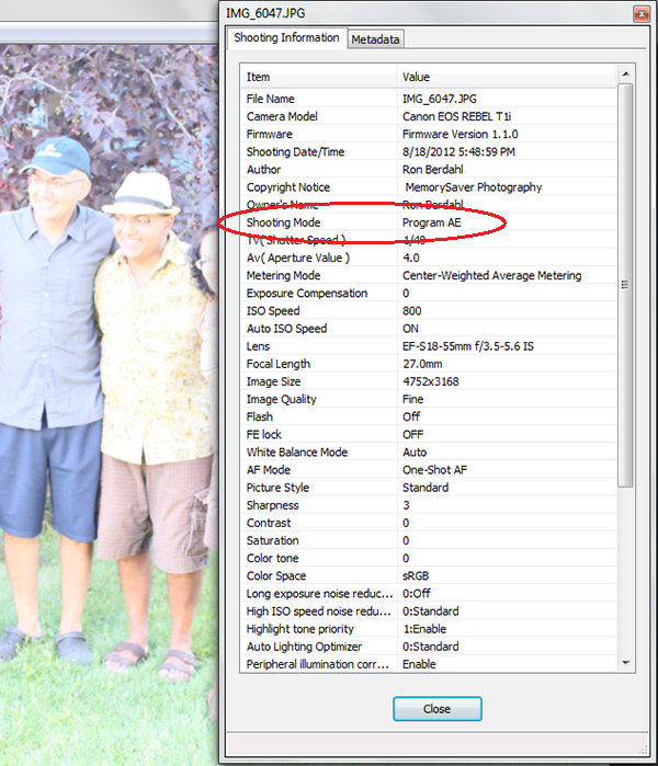

melcat wrote: OP claims it was shot in "P".
The EXIF code in his image for Exposure Mode is '0'. That would be "Full Auto", the box symbol, not P.
P is not Auto ISO.
Aug 21, 2012 at 11:36 AM
BrianO
p.2 #2 · Help please...Canon T1i overexposure problems
Monito wrote: The EXIF code in his image for Exposure Mode is '0'. That would be "Full Auto", the box symbol, not P.
Not only did the OP state that he was in P, but I checked his photo in DPP and it also lists the mode as "Program AE."
Would DPP say "Program AE" if "Full Auto" were activated?

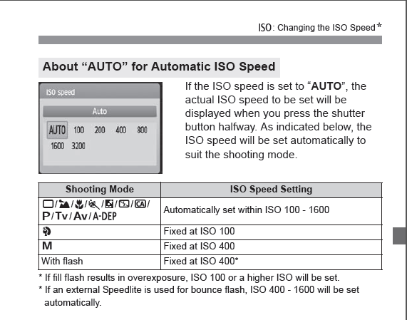

Monito wrote: P is not Auto ISO.
If you mean you can't use Auto ISO in P mode, that's not correct.
Aug 21, 2012 at 06:20 PM
Monito
p.2 #4 · Help please...Canon T1i overexposure problems
OK, thanks. Some Rebel modes work differently from other cameras, I see now.
Re: P vs Full Auto, I'm going by the codes shown by his Picassa link and their meaning as Canon tags:
http://www.sno.phy.queensu.ca/~phil/exiftool/TagNames/Canon.html
CameraSettings tag 20: CanonExposureMode 0 = Full Auto
Picassa says "Exposure Mode 0".
Aug 21, 2012 at 06:35 PM
