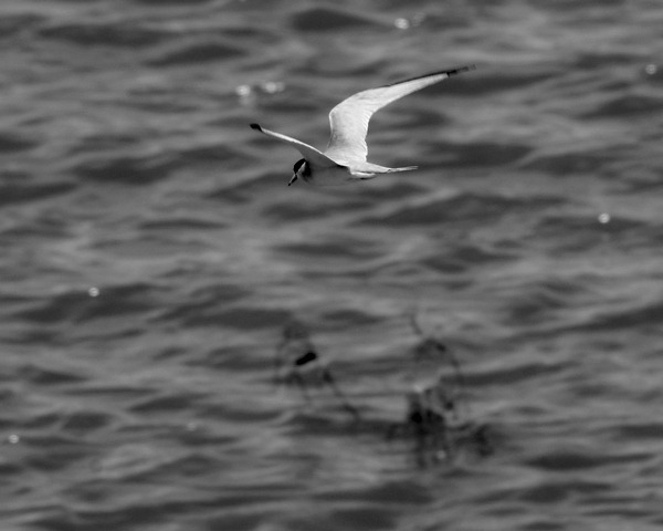

sounds like a issue, here is a pic of a tern with my previous d7000 over 75 feet away, 70-300 d ed af lens, the focus is spot on
Joe
  NIKON D7000    300 mm    f/11.0    1/400 sec    280 ISO    0.0 EV

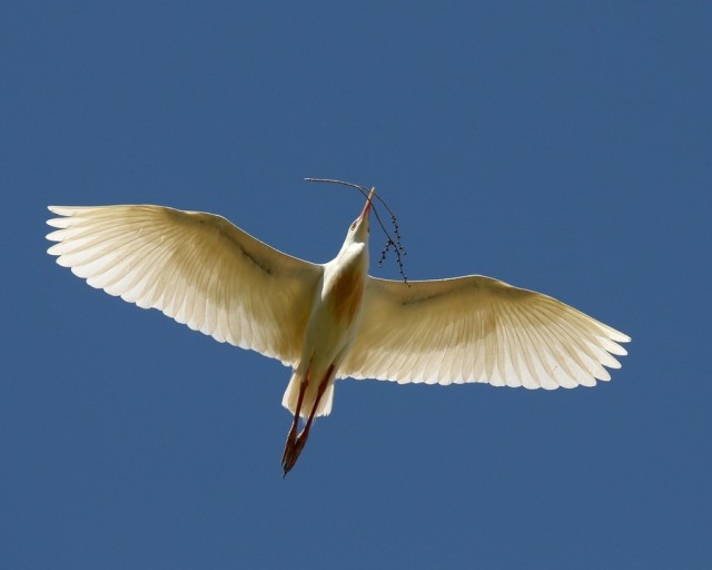

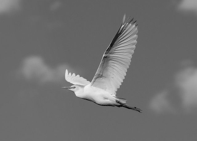

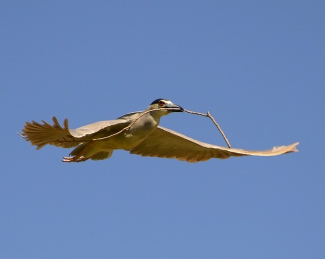

BIF with the D7K and 70-300 VR I may know a little about THAT
  NIKON D7000    210 mm    f/6.3    1/2000 sec    400 ISO    -0.3 EV
  NIKON D7000    300 mm    f/6.3    1/1600 sec    400 ISO    -0.3 EV
  NIKON D7000    230 mm    f/8.0    1/1250 sec    250 ISO    -0.7 EV
