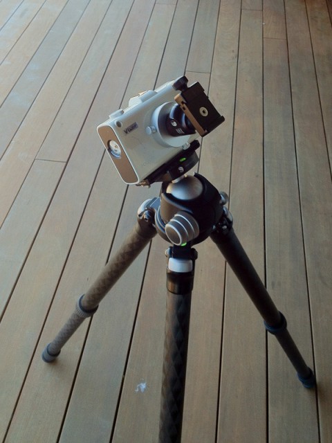

I recently purchased the Polarie and have been very happy with it. As shown in the pic, I added a short plate to the bottom for easy attachment to my existing tripod / ballhead. I also added a 2nd ballhead to attach my D800. If you want to stack multiple exposures, the polar scope is also recommended to attain accurate alignment. There's a ton of astrophotography info at cloudynights dot com and especially the DSLR & Digital Camera Astro Imaging section. GL, dave
