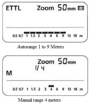

What is the purpose of setting the distance indicator display to feet? Nowhere on the flash display can I find anything displayed in feet. I know the Nikon SB-900/910 displays the distance in meters and might be able to display in feet, but can't figure out if and how to get the 580 EX II to display distance at all. I'm pretty sure it can be displayed in ETTL mode, but can't figure out how and would rather shoot in manual anyways. What am I missing?

no_surrender wrote: ...Nowhere on the flash display can I find anything displayed in feet. ...can't figure out if and how to get the 580 EX II to display distance at all. I'm pretty sure it can be displayed in ETTL mode, but can't figure out how and would rather shoot in manual anyways.
The 580EX II (and the EX) show a bar-graph at the bottom of the display that indicates the range.
In ETTL mode you will have a range of bars indicating minimum and maximim range, and in manual mode you'll have a single bar indicating the range for the chosen power level and aperture.
BrianO, how do I get the range to display? (In manual mode)

no_surrender wrote: BrianO, how do I get the range to display? (In manual mode)
It should always show when it's in normal mode, whether ETTL or Manual. If it isn't, then you're still in a function-setting mode or something.
You'll also need to have the flash on the camera and half-press the shutter button once to transmit the aperture and ISO info to the flash.

I have the 580EX II mounted on my 5DM2 with the following settings:
Camera:
Manual exposure
ISO 100
Tv 1/125
Av f/5.6
RAW
Evaluative metering
One Shot AF
Single Shot
White Balance Flash
Picture Style Portrait
Lens:
50mm f/1.4
AF On
Flash:
Custom Function 00-1 to convert to feet (which is not displaying)
Mode Manual
Zoom 50mm
Zoom Manual
Master Ch 1
1/128 power
Flash is mounted in camera hot shoe
On a side note, my 3 ft Vello TTL cord would not fire the flash when mounted on the 5DM2, but does (last I checked) on my 30D. I have a 24 ft Flash Zebra TTL cord that works on both camera bodies.
Edited on Aug 18, 2012 at 04:46 PM · View previous versions

Do you have the row of numbers on screen but no bars showing, or do you not even have the numbers?

Thanks for the link. No numbers at bottom.

I think you may be in Wireless mode.

Disabled wireless and the distance meter immediately displayed, thank you. What is wireless mode?

no_surrender wrote: What is wireless mode?
Wireless mode allows the flash to act as either a Master or Slave, and control or be controlled by another Speedlite.
When in wireless mode, there's a whole slew of commands that have to be sent back and forth between the various Speedlites, and so if you're not using a Slave, the Master gets confused when it doesn't receive the talk-back from the non-existant Slave. I think that's what was happening to you.
