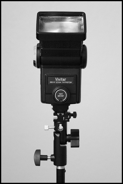

Vivitar 283.

Still have my Vivitar 283 and 285 from way back in my A-1 film days and they still fire off fine. If you want a Canon branded flash then I'd suggest the 300TL, I've a few of these for my T90 bodies and they are also still working. Check here on FM's Buy&Sell forum 1st, e-bay or most of the major photo shops have used ones, check B&H, Adorama or KEH, they usually go for $25 to about $85.

viv 285

Otherwise, as everyone suggests, the Vivitar 283/285 would be a good solution. The only benefit to a flash with Canon dedication is it would set the camera at 1/60 and might even set the aperture based on the aperture/power output selected on the flash (with the aperture on the lens set to A).

I used an AE-1 Program for years, and I used both Sunpak and Vivitar flashes with it. The Vivitar 285HV is still being sold, and for less than $90 it has the most bang for the buck of any flash I've used in recent memory.
It has a built-in auto-sensor with four apertures available, as well as a manual mode, and there's a built-in calculator dial to show what the range will be at given apertures and ISO settings.
http://www.bhphotovideo.com/c/product/61441-REG/Vivitar_233965_285HV_Flash.html
Even though I have three Canon Speedlites, I'm hanging on to my 285HV.
