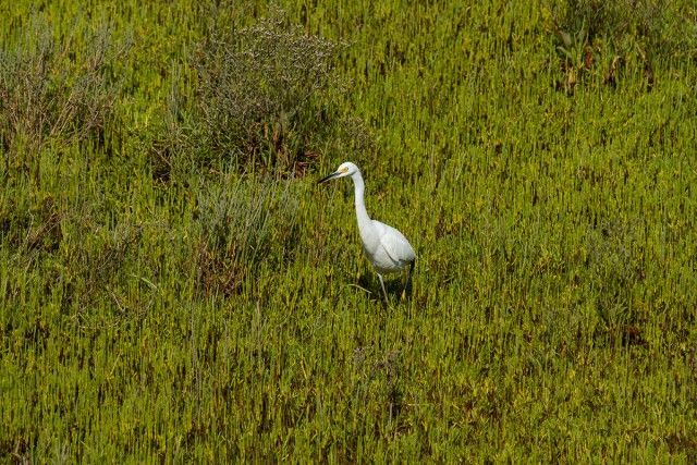

when i say soft, i mean "not usable". i really do not think this is a 7d vs. 1d issue although that is an interesting. i use to get very nice images out of my 7d and now i cannot get anything that would make the cut for my webpage. i do not need to look at 100% to tell something is wrong. yesterday i had an american goldfinch not 15 feet from me on a thistle for a full minute and walked away with ZERO keepers. i was so frustrated that i tossed all the files out before posting this. these are examples of some shots with my 7d previously so you have an idea of what i define as a keeper. these birds were as far or further away that the finch i was shooting yesterday.
  Canon EOS 7D    500 mm    f/8.0    1/125 sec    400 ISO    -0.3 EV
  Canon EOS 7D    700 mm    f/8.0    1/640 sec    200 ISO    +0.3 EV
  Canon EOS 7D    500 mm    f/8.0    1/400 sec    100 ISO    0.0 EV
