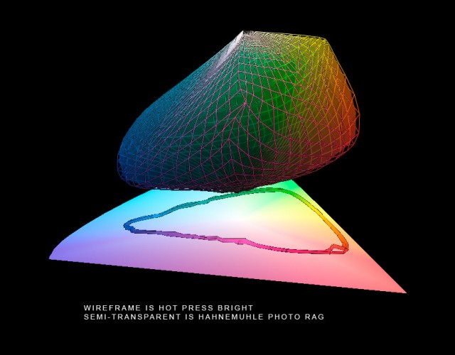

Peter Figen
p.1 #6 · Alternative to epson hot press bright?
Here's a ColorThink 3D rendering of the respective gamut maps. There's a very slight overall edge to HPB, which is the wireframe, but they're so close that you'd never see the difference in the real world.

p.1 #7 · Alternative to epson hot press bright?
Thanks Peter - that's awesome - I think I'll be stuck looking for another option based on the thickness of the Photo Rag - but since I love the fine art pearl so much my curiosity is going to get the best of me for a few sample prints.
