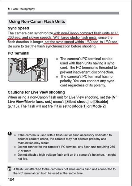

If you read the section about manual flash in your camera's manual you will find Canon tells you not to expect external flashes other than it's speedlights to sync at the rated limit of 1/200th — for all the reasons stated above by others.
All gear has specified physical limits. With a focal plane shutter the time it takes the first shutter curtain to open completely caused the sync. limit. You press shutter, the camera waits about 1/300th sec. until the first curtain is clear of the sensor then fires the flash. If there is any latency between the time the "fire" signal is sent by the camera to when the flash actually fires it goes off as the second curtain is closing producing the black shaded bar on the long dimension of the frame.
The solutions include: 1) slow the indicated shutter speed (which delays the closing of the second curtain), 2) get the latency out of the external flash system; or 3) buy a pro body with a higher 1/500th sync speed, or alternately a crop sensor than the shutter can clear faster (1/250th vs. 1/200).

BrianO
p.1 #11 · Sync strobe at faster than 1/160 ?
safcraft wrote: ...I am using a Canon 5D...If i go higher than 1/200 my camera does not sync...
Yes, as mentioned above by others, 1/200 is the sync limit on the 5D. In fact, when using other than Speedlites, often anything above 1/160 won't sync.
Are you shooting indoors or outdoors?
safcraft wrote: ... I am newb on strobing...
In case you're not clear on how sync speed works, here is a video with a vary good explaination:
http://www.pocketwizard.com/inspirations/tutorials/pocketwizard_controltl_optimiz/
It's a promotional video for Pocket Wizard, and mainly relates to Speedlites, but at the beginning there is a sync speed tutorial.
By the way, here's what Canon says about the 5D's sync speed:
Jul 16, 2012 at 05:50 AM

I can vouch for the 1/160 the maximum speed on the 5D. At 1/200 i get some curtain shadowing already.
