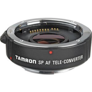

I found a 1.4X non-reporting TC's that auto-focus with 5D III nicely at F8 (no taping of pins)
works for BIF as focus is very usable.
Tamron-F AF 1.4x teleconverter (non-reporting)
http://www.bhphotovideo.com/c/product/53109-REG/Tamron_AF14C700_1_4x_Teleconverter_for_Canon.html
Tamron 1.4X TC
5D III / Canon 400mm F5.6 / Tamron 1.4X TC
